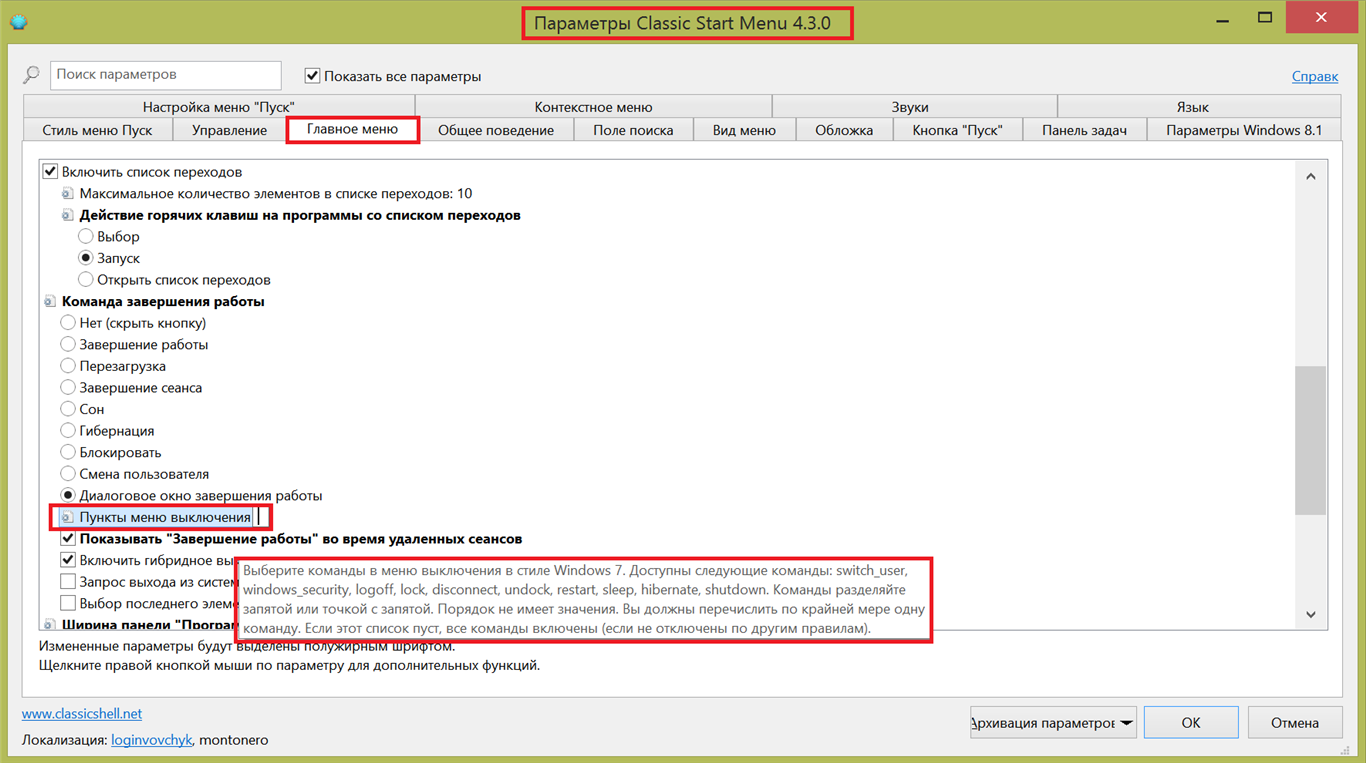

Здравствуйте!
Подскажите пожалуйста, как удалить из меню некоторые элементы?

Look at the Setting: Shutdown menu items on Main Menu tab. Hover over it to read its tooltip help. For that setting, you need to specify the commands you wish to show in the Shutdown menu. The ones you omit will be hidden. The possible commands are: switch_user, windows_security, logoff, lock, disconnect, undock, restart, sleep, hibernate, shutdown. Separate the commands with a comma or semicolon. The order of commands is not important.

leaving it blank defaults to all the settings visible, putting an invalid command results to it still opening with the word 'blank' instead of any commands. I think he is looking to remove the submenu entirely
PostPosted: Tue Apr 11, 2017 7:49 am
Follow these steps:

Ok! Yes! Happened !!!!
