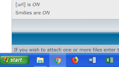

I've used this program today for the first time and I must say this is fantastic. It's sad to see further development stop, but it's still good nonetheless. However, I have a very nagging problem: I am using this program running Windows 10 on a Dell Inspiron 13 7000 Series laptop. I've customized my taskbar and start button to be as close to windows XP as possible, but my start button is not able to fill the entire slot of the taskbar (there is a space above and below the start button showing the taskbar). I've tried resizing the image in different programs but that does not help. Trying to resize the start button in the Classic Shell program has not helped either. I want to increase the height of the image but I'm at a loss of what to do.
I've attached a screenshot. Any help is very much appreciated!

Looks like your taskbar is 46 pixel height.
I don't think there is one that matches that size.
There is a 39 pixel height XP button in the Start button section:
viewtopic.php?f=18&t=3206
To get to exactly match, would need to edit the image in a photo editor program.

If want to use the 'pixel perfect' size if your image, set the size to 0 in classic shell. then edit the image in whatever program you use, till its height matches the size of your taskbar (x3).
If you arent that picky pick a size 46 here, and adjust from there...
Unless you are saying the 'button size' option in the 'start button' tab did nothing?
