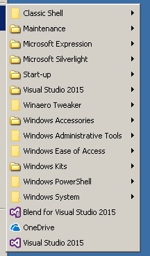

I configured Classic Shell on my Windows 7 system when I first installed it about 3 years ago. I've installed Classic shell on a Windows 10 VM but unfortunately the submenu folders don't look the same and I can't remember how I configured them or even if I configured them.
I've attached a couple of pictures to show the difference.
Does anyone know how to change the submenu folder icons please?
Thanks,

Thanks for your suggestions. I've been using the shell32.dll, renamed to shell32-xp.dll, from an XP system, and using the following articles to change the open and closed folder icons and these worked fine with File Explorer, where they are used.
http://www.sevenforums.com/tutorials/23825-folder-icon-change-windows-7-default-folder-icon.html
http://www.sevenforums.com/tutorials/23878-open-folder-icon-change.html
However, with Classic Shell, it seems to pick up the "wrong" icon for stuff that was installed before I made the above changes and the "right" icon for stuff that was installed after the above changes were made. See attached picture.
You can right click on the menu item, e.g. Maintenance in the attachment, click Properties->Customize->Change Icon, then browse for the shell32-xp.dll I mentioned earlier and pick the correct icon but that's a lot of work if you have many subfolders and many levels of subfolder. I think I must have done it a different way in the past but I can't remember.
Regards,

Try clearing the cached icons. From the Settings click on Backup, then Clear cached information.

Hi, yes that worked. Thanks for your help.
