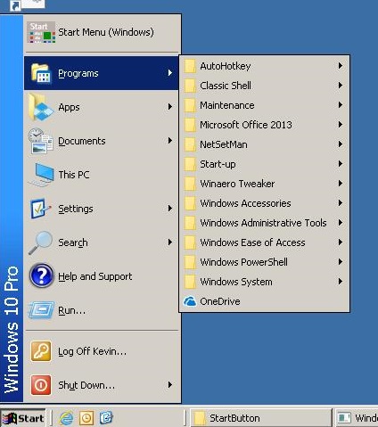

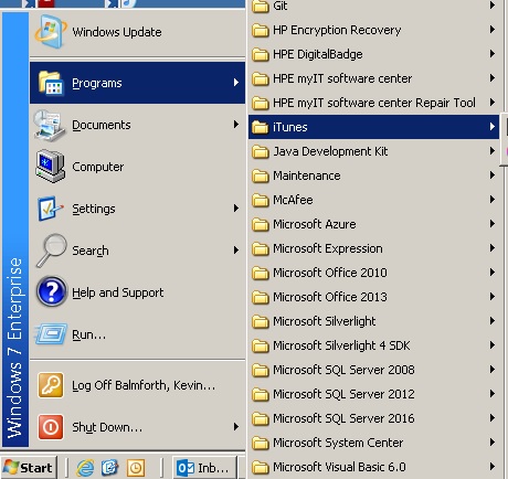

I've been using Classic Shell for many years on a Windows 7 system. I've installed it on a Windows 10 system and the start menu has black lines round it, which aren't on my Windows 7 system.
Does anyone know how to get rid of the black lines please? I've attached a couple of pictures to show the difference,
Thanks,

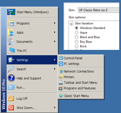

I'm guessing you are using a special theme/hack to get that look on the taskbar,
for as far as I know Win10 can't do that.
It is possible that your theme/hack might be able to get the 3d border menu edge look,
by using the "Classic Skin" that comes with Classic Shell Start Menu program.
See if checking the "3D border" option in the skin options does anything.
R.O.B made some classic skins, but I think most don't show 3d borders on Windows 10.
He has the exact bright blue caption area bitmaps.
It might be best to download a skin with the built-in 3d border in the bitmap image.
Try "XP Classic Retro rev E" skin.
download/file.php?id=5143
It is not going to show the Windows 7 blue caption area, as it is the XP version.
Disabling the search box, font smoothing, and selecting Tahoma font gets menu look closer to what you have.
Its menu skin font size is a little bigger -9, than yours.
If the skin is not good enough, time to make your own exact Windows 7 Classic skin :)

I tried the "XP Classic Retro rev E" skin and it does fix my original problem but the font is different.
I think I know how to change Fonts in skins using Resource Hacker, so does anyone know what the fonts are in my original post please?
Thanks,
PostPosted: Thu Aug 30, 2018 10:04 am
If I compare your Win7 menu text,
looks exactly like Main_font="Tahoma",normal,10
If you open up a copy of the retro skin on the desktop with Resource Hacker
open "SKIN" folder "1"
Go to Line: 1364 (close to the end of the text)
and change the font size from -9 to "10" (without the dash).
Click on the "Compile Script" button, and save with a different name.
Copy that modified skin to the skins folder.
Might have to restart CSM for it to appear in the skin list.
If it this is too much to do, I can make a simplified skin for you sometime Friday/Saturday.
PostPosted: Fri Aug 31, 2018 1:55 am
Posts: 51
I tried your suggestion and it only worked for the main menu, with the submenu and submenu items still having the wrong font so I also changed the other items in that section so it looks like this:
[TAHOMA_FONT]
Caption_font="Tahoma",normal,16
Main2_font="Tahoma",bold,10
Submenu_font="Tahoma",normal,10
Submenu_separator_font="Tahoma",bold,10
Submenu_separator_split_font="Tahoma",bold,10
Once I picked that skin in Classic Start Menu Settings, I also had to select the 'Tahoma font. Turn off Clear Type for sharper classic look' option at the bottom of the list of options for that skin.
This now seems to work correctly.
Thanks very much for your help,
Kevin
