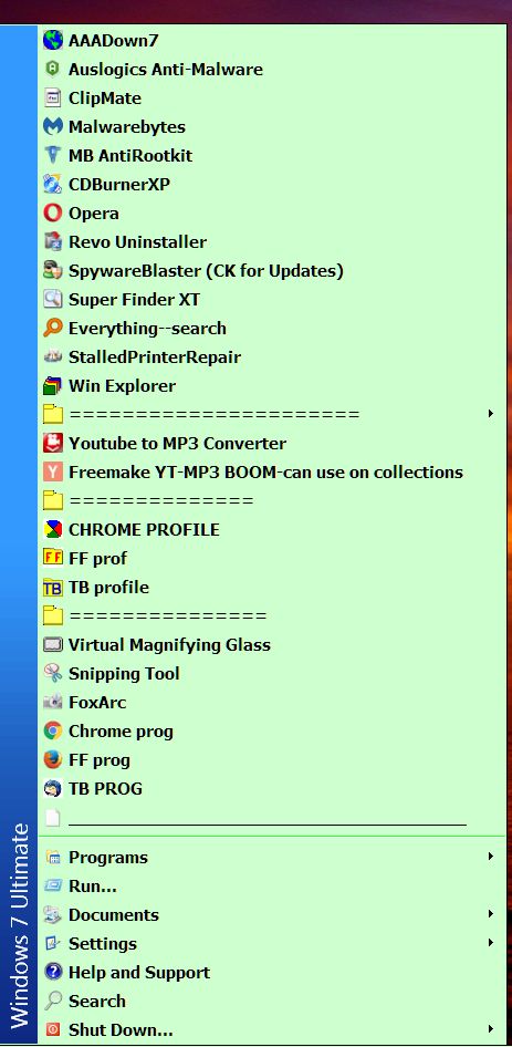

I have 2 desktops. I always arrange my Start Menu like this attachment. On this, the HP, I have one column with commonly used links on top, and the Program Menu at the bottom opens to a 2nd column. Below Programs I've chosen which links I want. "Documents" is recent doc accessed. It was all customized with CS
I'm setting up a 2nd desktop, (named Gateway) and I've run CS, copying my settings from this computer. I restarted, and the default menu is still there. Maybe I left some setting out. Or can I just copy the Backup from HP to Gateway into the proper folder? I have presumably a profile folder in MyId>Appdata>Roaming, but it's empty. i aslo have one in AppData>Local with datacache.db. Is that my profile?

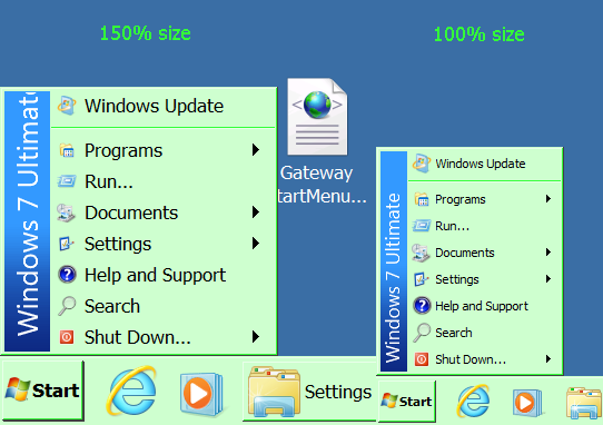

Well, that's a bummer. So what I did now is try the newly changed settings on a Windows 7 system.
It works for me, but as I suspected, all your Windows shortcuts don't show up above the basic menu.
Make sure to exit CSM and open CSM settings shortcut to get CSM menu restarted.
I don't see any more Chinese/Asian symbols in file, but I do see again that strange set of numbers section further on down:
<SkinOptionsA>
<Line>E87963C2|80316ABF|</Line>
</SkinOptionsA>
I've seen stuff like that on another XML file from davestewart.
His XML file version was version"4.2.4" but still worked on CSM version 4.3.1
so I did not touch it in your file.
Well, I don't know what else I can do to help. Must be some kind of registry error on your computer?
Hope someone else comes forward with the same problem, and with their fix.

The shortcuts above the basic menu are the ones I put there, not MS's list. I'm an iconoclast. They're the ones I would use most often while on the web.
Got it working fine now.
