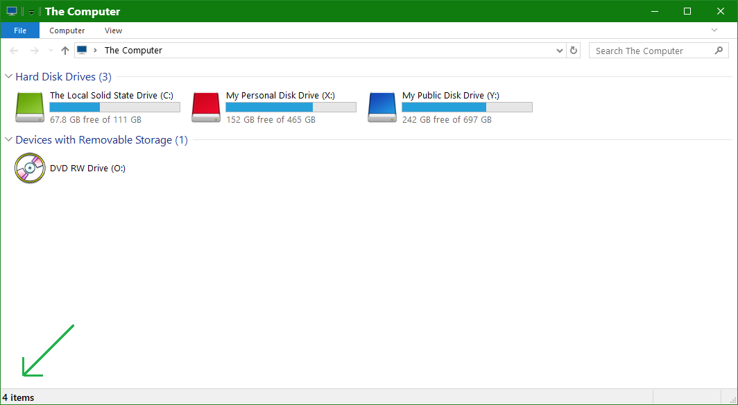

Hello,
If this has been discussed before, I apologize for not being able to find the thread for it. But I attached a picture of what I'm talking about. Is it possible to increase the font size of where it says how many items are in a folder & the size of the total files there. I drew green arrows that point at them.
Thanks

PostPosted: Sun Apr 03, 2016 11:53 pm
If you increase your Windows system DPI (set DPI scaling to a higher value), the font size of the text in the status bar is scaled. However I think in the future, Ivo may have to increase the height of the status bar, so the large font fits inside it.
PostPosted: Mon Apr 04, 2016 11:40 am
Joined: Mon Apr 20, 2015 11:29 pm
Posts: 30
Thanks for the suggestion. I tried messing around with the DPI settings and noticed that just increasing it one notch (from 100% to 125%) increases the size of a lot of other things just way too much. It would've been nice if Microsoft programmed that setting for me to put any number I want (for example 103%). But things get way too big.
What you said is such a great idea! Can you please mention this to the Classic Shell programmer to integrate that option to increase the height of the status bar, and the ability to increase the font size (and maybe change the font type) within the application itself?

PostPosted: Mon Apr 04, 2016 10:06 pm
You can increase DPI by point percentages too. Click "Custom sizing options" and enter the percentage there. e.g. 105% or 107%.
PostPosted: Tue Apr 05, 2016 11:43 am
Posts: 30
Oh, I never knew you can type in a new number or adjust the ruler by dragging it. I clicked the drop down menu and just assumed that the options are restricted to those values. But still, changing the height of the status bar, and font size, is more preferable for me.
PostPosted: Tue Apr 05, 2016 1:09 pm
Posts: 30
Alright, so I messed around a bit again with all this. I noticed that I prefer to keep the DPI at exactly 100% since that is what is shown as accurate (for example, when I want to type a document, I want to see its exact size before printing it; I don't want to see it enlarged on the computer and notice that it's actually small when I print it).
I've actually temporarily fixed this in the past, yet reverted to its small size again because of other conditions. As a matter of fact, I found exactly what can make that font bigger (I'm using Windows 8.1):
Right click Desktop -> Screen resolution -> Make text and other items larger or smaller -> At the bottom, select Tooltips & change that font size. That is the exact option to change the font size for what I want to change in that picture above. Yet I use a program called Media Player Classic a lot (it's an audio/video player) and the thing is that in the bottom of that program, the word "Playing" gets enlarged and the bottom of the letters "y" & "g" don't show. I don't like how it shows that, so I revert back to the smaller font so the whole word is visible.
So the only resolution is if Classic Shell can implement the feature we were talking about earlier. It would be so great if that's possible. Thanks
