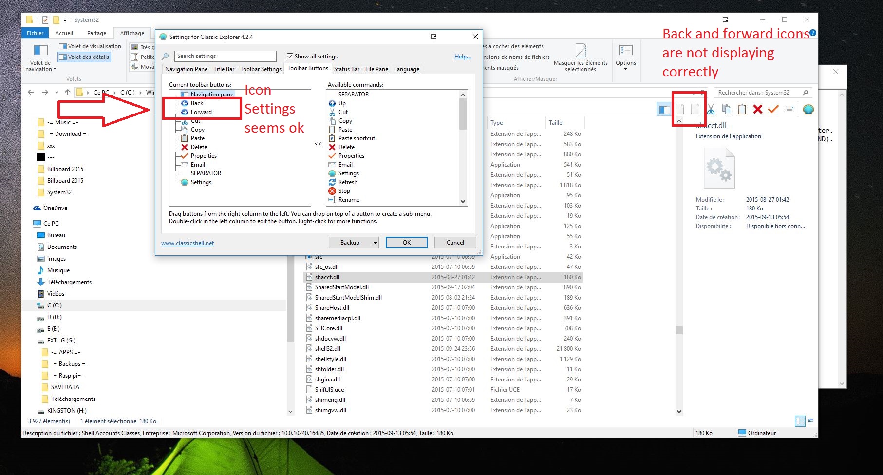

I did search a lot and I don't understand why I am not able to set an icon for back and forward buttons in the classic explorer toolbar.
Actually I can change the location of the icon, but it does not shows up when I reopen explorer.
I'm still stuck with blank icons :(
I am using Windows 10 x64.
Here is a screenshots to help you see what I mean.
Any help would be very apreciated.
Thanks ! :)

Attach the icons here.
In which folder do you have the icons?

After reading your answer I made 2 things and it worked !
Either that using a .dll icon file that I had stored in C:/Windows/system32/, I putted the .dll icon file in my documents windows library.
Also, I did set a path for the disabled icon.
Everything is fine now.
Thank you for your help.
