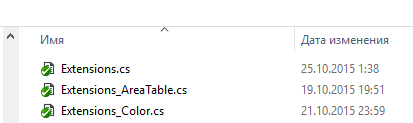

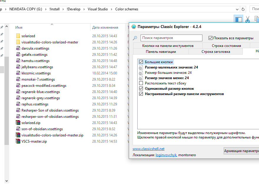

Can't get icons size adjust working for Explorer Details / table view, even i set up all to 24 size, still icons showing small - 16*16
Is there a way how to fix this ?
On W7, icons were view good (you can see icons even with svn icon added to them, but in w10 i almost can't see icon :)

The setting is for the buttons in the toolbar, not the files in Explorer.
Is there way to change icon size for files ?
PostPosted: Sat Oct 31, 2015 5:51 am
You can increase your system DPI. Type: dpi into the Classic Shell Menu search, open DPIScaling.exe. Click "Set a custom scaling level" and set it above 100%. On Windows 10, you can also change it from the Settings app. Then log out and log in again. Your Explorer Details/Table view items should be larger.

it's not same, as it will increase size of text, which i do not want to change, only icons size
PostPosted: Wed Nov 04, 2015 7:33 am
Then there is no other way. The File (right side) pane of Explorer uses an undocumented control so third parties can't predictably modify its behavior.
