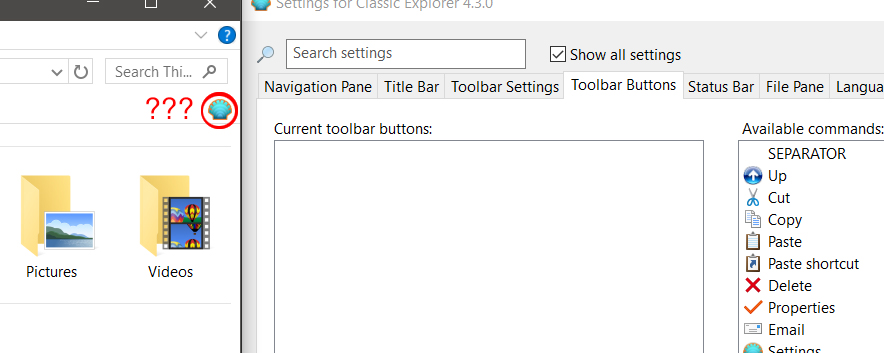

Hello everyone. It seems I can't disable the toolbar in Windows 10. I'm using Classic Explorer 4.3.0. I removed all the toolbar buttons, but the settings button still remains. So, how can I completely remove the Classic Explorer toolbar?
Here is an attached image that describes my issue.
Thanks in advance! :D

Open Control Panel and press F10. Right click on the Menu bar (File, Edit......) and uncheck "Classic Explorer Bar".
Another way using the Ribbon UI of Explorer is to go to the "View" tab of the Ribbon. Click the tiny arrow below the Options button and uncheck "Classic Explorer Bar".
