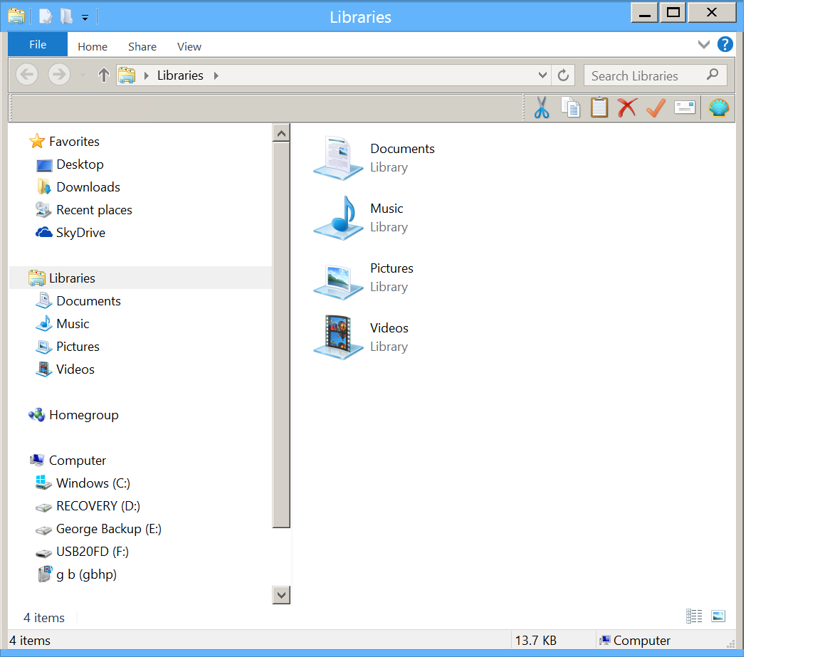

Let me clarify something: the problems I am experiencing are with INTERNET Explorer (not FILE Explorer, as far as I know. I have attached a screen shot of what the File Explorer window looks like.) I also just realized that the problem I'm experiencing may have to do with a THEME that I installed around the same time as CS; I'm just not sure who's doing what. (Aside to Gaurav: belated thanks for the Theme you posted for me. I later found this one:

I have also attached a screen shot of what IE looks like when I open it (and please let me know if you would prefer a different graphics format, etc.) Problems:
(1) There is no "tab bar" or other toolbars at the top. Previously, these bars ALWAYS appeared, and were in a format similar to what I used to see in Win XP (using the "Classic" Theme for XP, not the "XP" Theme, if you know what I mean.) If I push my mouse cursor up to the top of the screen, a toolbar of sorts appears; but it seems to come and go of its own accord. And when it is there, it covers up part of the web page (often, the important navigating features are at the very top!) This toolbar does NOT look like the one I had before. With regard to the "covering up", I think there may be some issues here with parts of Classic Shell still loading and working.
(2) The Task Bar at the bottom goes away when I go into IE. Previously, this would stay in place when I opened an IE window. In response to Jcee, I do have the Classic Shell Start button, when I have the Taskbar!! But no Taskbar in IE, etc.
For these reasons, I believe (in response to Ivo) that I have been kicked back to a Metro look.

- Thank you for expanding on the wording about the Status Bar. Again, it appears that this is related to FILE Explorer, not INTERNET Explorer.

10-11-2013 Classic Shell - INTERNET Explorer.png [181.89 KiB]
Downloaded 4045 times
