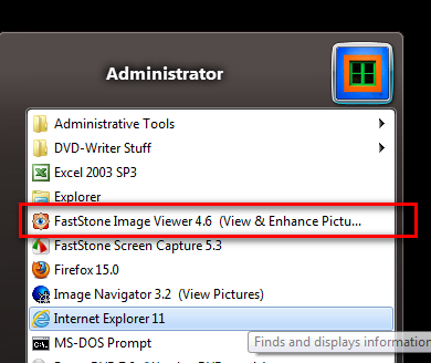

PostPosted: Mon Nov 18, 2013 10:52 am
Joined: Mon Nov 18, 2013 10:44 am
Hi Guarav,
Actually you are incorrect. The original submitter of this bug is correct.
There is most definitely a bug and that is the only reason I have registered to the forum today - to highlight it.
I installed 4.0.2 over 3.6.8 and, straight away I have endless menu entries with ..... at the end, and the width of the entry does not matter, it is totally arbitrary. I have longer entries than the one below on the main Start Menu and they get cropped, and this one below, on the Programs Menu also gets cropped. Changing the WIDTH setting (which I had never ever touched in my entire history of using Classic Shell) makes not one bit of difference no matter how high or low I go.
Environment : Win 7 Pro 64-bit, IE 11.
I have done further tests : the problem does not happen with 3.6.8. It also does not happen with 4.0.2 if only IE9 is installed. From IE10 onwards, 4.0.2 gives this problem.
If I uninstall 4.0.2 and revert back to 3.6.8 the problem goes away.
Ilka.

I don't see how the version of IE can make a difference. Can you attach two pictures of the same menu with IE9 and IE10, or with 4.0.2 and 3.6.8? Also save your settings to XML file and attach it here.

1) By default right-click on the start button opens the menu that has the settings. Maybe you have checked "Right click opens the Win+X menu"?
2) The problem is caused by the & symbol in the name. It causes mis-calculation of the text size.
 Post subject: Re: 2 issues in 4.0.2
PostPosted: Tue Nov 19, 2013 9:44 am
