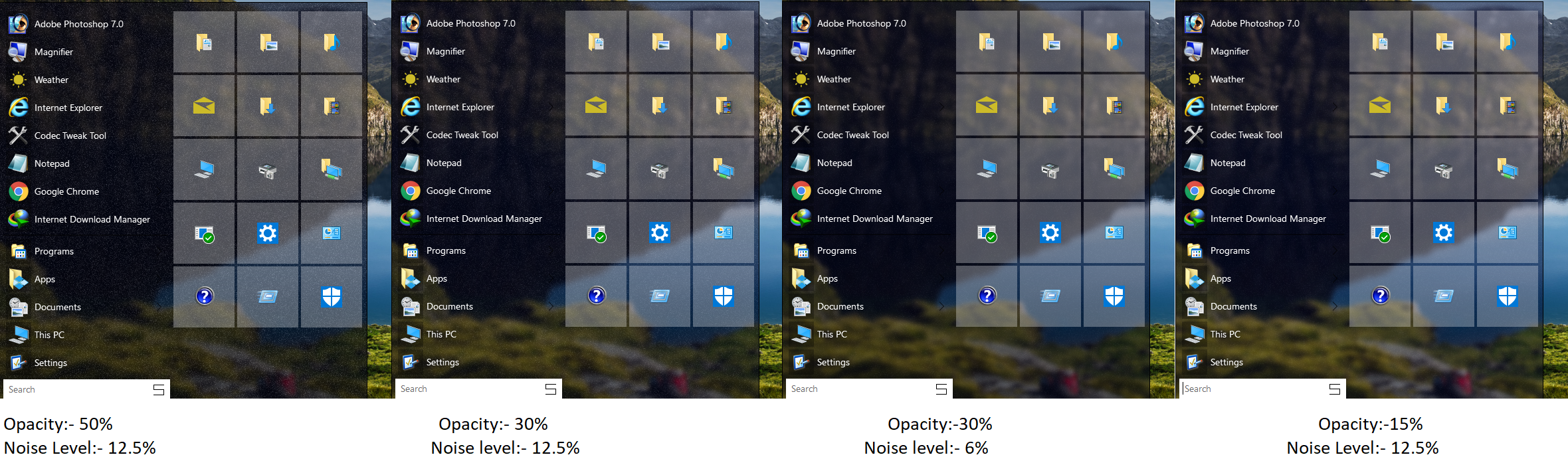

Hi tries Alpha Noise with the pattern.
Looks good at low levels.
How do you feel about it?
For search box background, I meant that It become large like in the omni-pic.
I don't understand by what you mean by extension.
Noise Menu.png [2.01 MiB]

Oh meetHG.
You are so clever, how you used same desktop background as Splitwirez. :)
Low levels noise looks better than high levels. Looks like there are different types of noise in photo editors:
Uniform, Gaussian, dither, monochromatic.
My sample picture was not a good reference. It had modified dither noise with vertical gradient.
I wonder if MS has a sample noise image in one of their files somewhere, or is it just code that makes the noise?
If I open the "Photos" app, and make a screenshot of its active title bar in front of white/black background, this picture is what it looks like.
I duplicated bar below to see better.
[How do you feel about it?]
You are going to hate me now. If I look at it too much, I want to wipe my monitor to get rid of the dust, but it's not dust,
it's the noise. :lol:
I hope I did not waste your time on a wild goose chase. If anything It looks better without the noise, or just have it on either the tiles part, or background part, but not both.

Hi Juniper and Redblade.
juniper7 wrote:
Oh meetHG.
I don't get it. How difficult is to set a Picture as desktop background?
Yup, You are right. I used the monochromatic uniform Noise.
If you want dither noise, I can put in and show you the screenshot. Your Call.
Well, same feelings here. This noise is not appealing. Looks like Dust.
It is about the same trick you played with tiles.
Yes, I embed the extension in the main_bitmap.
Well, it was working nicely for sometime. But when some menu entries are removed, the alignment goes out of balance.
Might Menu height should be fixed at some value to check alignment, but classic style don't have that option.
And I didn't tried to find the exact cause and solution to the problem. Busy with tile labels.
I tried emblems. They don't get hidden.
They might get hidden in your skin beacuse tiles were solid. May be not. Not Sure.
One Question. Are you Windows Insider?
From the screenshot, I see the elements of Microsoft's new Fluent Design System.
Well, I am also on Creator's Update, But My Apps don't have that blur and noise.
Also I remember the screenshot of Groove Music you send earlier to me during omni-pic development. It also have FDS elements.
