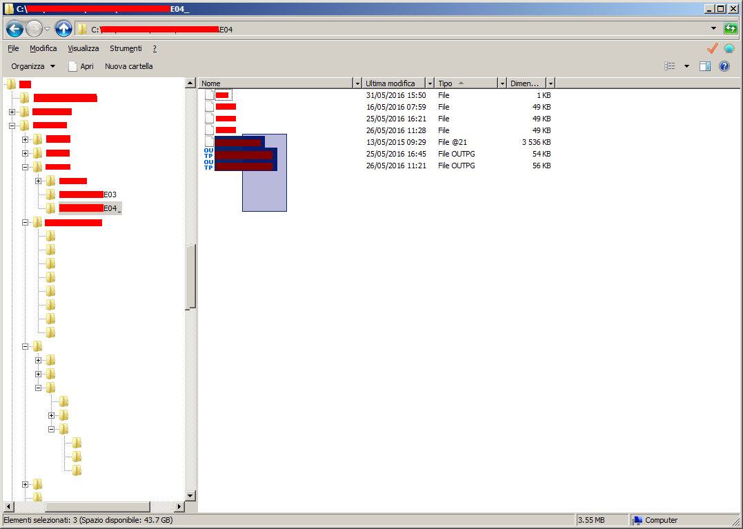

The "fig_1" shows how I view the contents of most directories.
It's more or less what I wanted. The selection mode is not "full row select", so I can easily select the files with long names, like I'm doing in the picture (the mouse arrow was not captured, but the light blue selection rectangle was, and four long-named files are selected...)
This feature is very useful for some works I usually have to perform.

In the "fig_3", I have just renamed the "buggy" directory adding an underscore at the end (as shown in the title bar on the top and in the tree panel on the left - the address bar remained unchanged... a minor bug, maybe, but it's not so important). And now the contents of this directory behaves normally!
