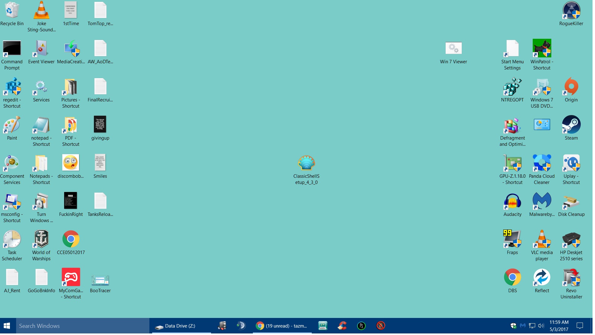

PostPosted: Wed May 03, 2017 9:12 am
Posts: 21
The one I have (and I will include screenshots) of the step by step that I see installing the utility. I uninstalled it an this is the sequence of re-installing.
Two more to follow.
Note:- I got the utility from the link you provided and it matched one I had gotten earlier. (4.3.0)

PostPosted: Wed May 03, 2017 9:15 am
You are running the installer. You need to download the Classic Shell Utility - further down on the download page.
